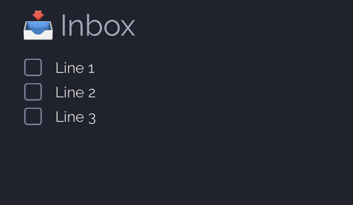

Below screenshots are after running the shortcut 3 times for each test to get the 3 separate lines.
Screenshot with tag
Screenshot without tag

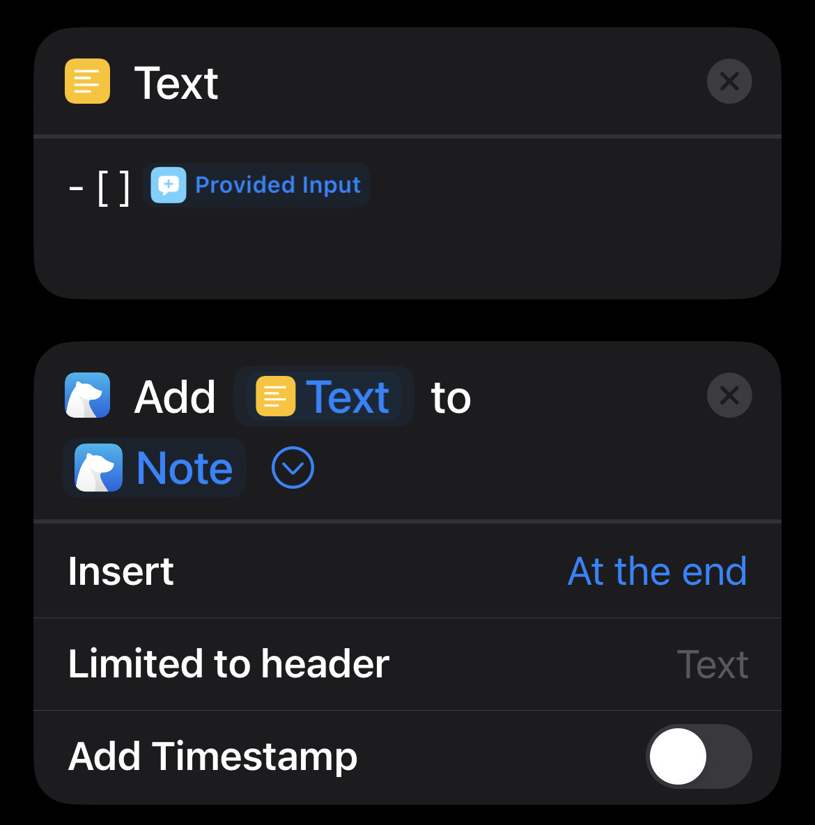

Screenshot of part of the shortcut
Any news on this ? Continues happening
By testing the above and checking for carrier returns at the end of the Text action, everything seems to work as expected. I suggest checking and eventually replacing the new lines in the Text action and the provided input before passing it to Add Text.
