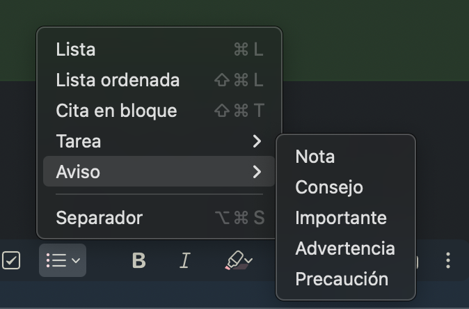

  • There is no keyboard shortcut to quickly add a callout.

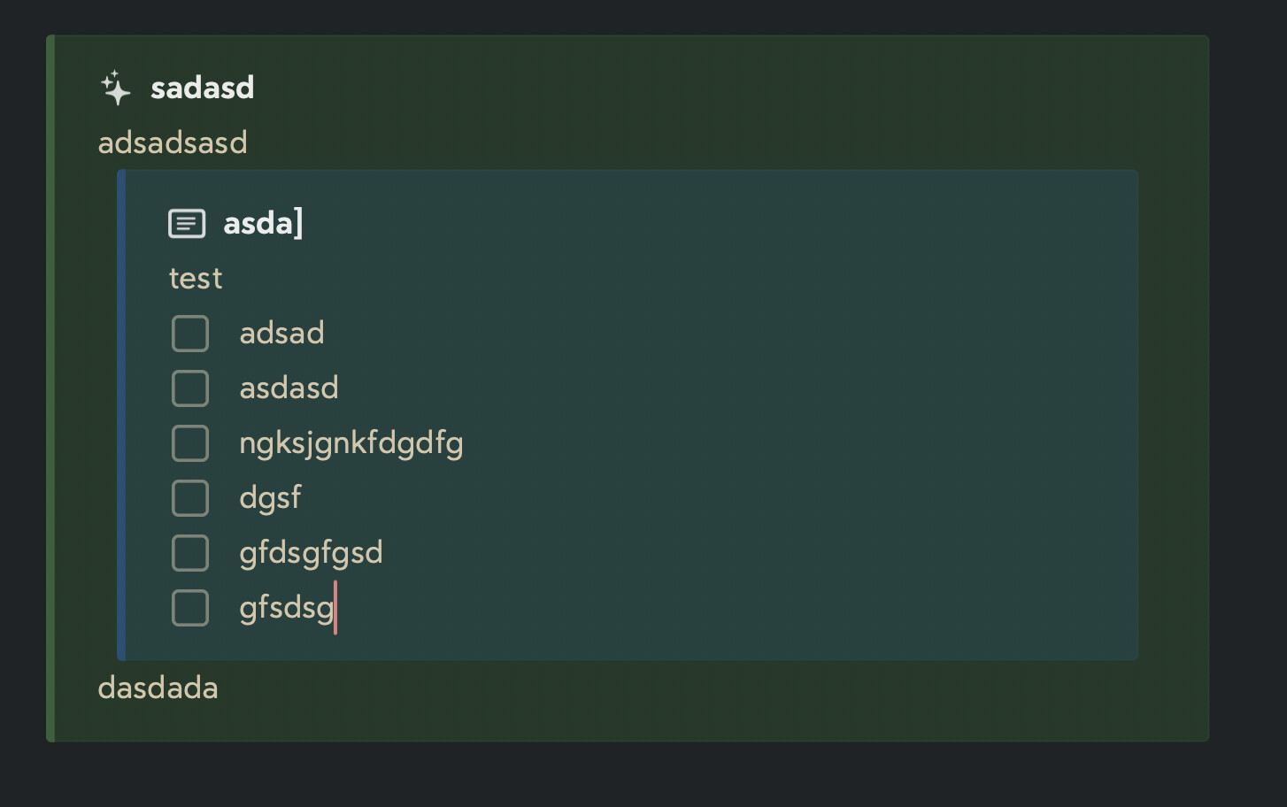

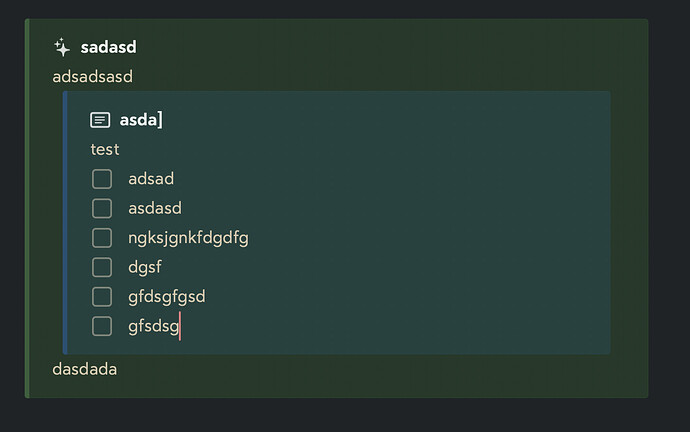

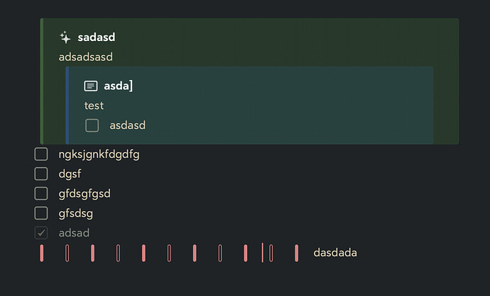

  • If you have tasks inside a callout and complete one of them, the UI is broken. This happens on both single callouts and nested callouts.

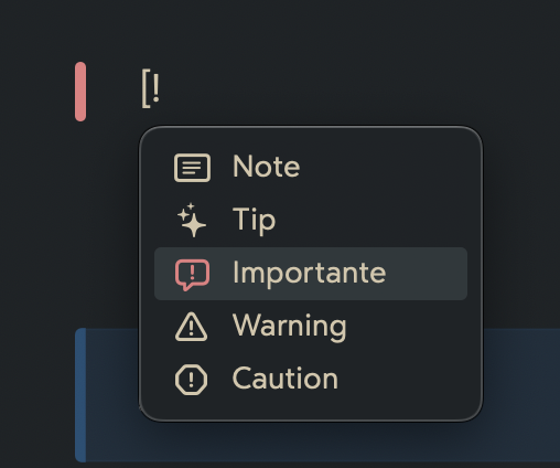

  • Callouts autocomplete the translated word, so it won’t work (It does not happen with the BIU bar, only the select menu and only on the callout creation, so modifying the callout type with the select menu will work):

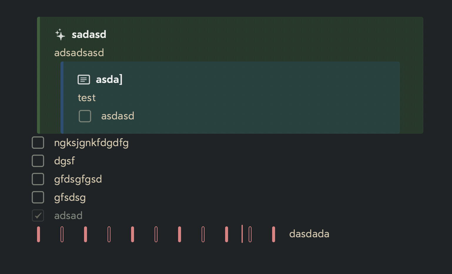

  • Weird glitch on completing tasks inside a callout

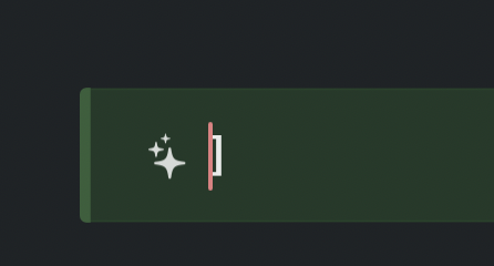

  • callouts breaks if a new line is insert between nested callouts. This also happens if the cursor is before the icon and press enter:
  • Suggestion: As i mentioned in a comment previously, there is no keyboard shortcut for this feature but a workaround would be to use the same shortcut as the block quote, as it inserts a “>” so 1 press at shift+cmd+T shows the quote and if you press again it deletes the quote. Would it be possible to add a step between? 1 press shows the quote, the second press shows the select menu (as if it inserts ‘[!’ after the previous “>”), and then the third press deletes the quote. I think this could be useful for using this feature with no typing.

The autocomplete and task completion bugs should be fixed with the yesterday beta!
This is by design as callouts behave exactly like list/blockquotes. I understand it might be not what you’re looking for and we’ll have a chat about that, but not closing the block when pressing enter on an empty line will make it very difficult to exit a callout.
Yes, you can always set a custom one if you need. We’ve added a new quicker way to open the auto-complete menu, now you just have to write > ! and the callout menu will be presented to you.
So, there is no technical possibility to do that 3 steps keyboard shortcut? I think it is the most logical thing given that callouts start with quotes “>”
