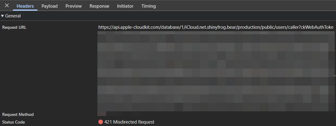

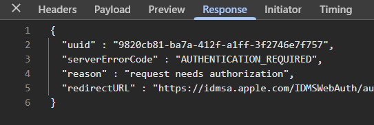

+1 — Even with “Trust this device” enabled, I have to sign in to iCloud every time I open Bear Web, even after a simple refresh. In DevTools, the CloudKit database request returns 421 AUTHENTICATION_REQUIRED and redirects to the Apple ID sign-in page.

Hi @bru , I’ve tried multiple browsers, including Chrome (with no extensions) on both Windows and Mac, as well as Safari on iOS, and the issue occurs every time. This makes me think it’s less likely a problem with Bear itself and more likely related to my account. I’m based in Mainland China and wonder if Apple requires re-login each time. But can Bear do to help prevent this?
Everytime I refresh my tab, I notice this request failed:
And if I use a non–China Mainland Apple account, there’s no problem: I don’t need to login again each time. I wonder if Bear needs to implement some additional configuration to address this issue for China Mainland users?
